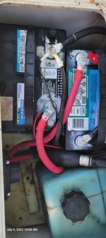

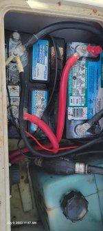

I accidentally hooked up my 2 marine batteries wrong. See before and after below. Once hooked up wrong I turned the selector switch to both and tried to turn the key to check power and had nothing. I noticed the wires were very hot and turned everything off. I then undid the wires and removed the batteries. I took to advance to get checked and was told to charge them, which I did. I installed them back the correct way and STILL HAVE NO POWER! What would be my next move? Any suggestions?

From your pictures I think what you had was the batteries in series for 24 volts and then a dead short thru your switch set to both. This may have damaged the switch. Depending on which battery is which you may have applied reversed polarity to your boat's wiring when you moved the switch thru the 1 position to both. If you you could have damaged a lot of things. If not it might just be a bad switch.
