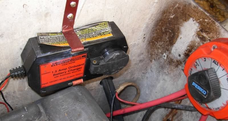

I have a floating charger also from harbor freight, but it is a permanent mount doo-hickey:
The little spring-loaded cover opens up and the extension cord plugs right in. The light lets you know when you have a full charge. I usually will plug it in a couple of days before an outing. With the Perko switch in the all position, it charges both batteries.​
