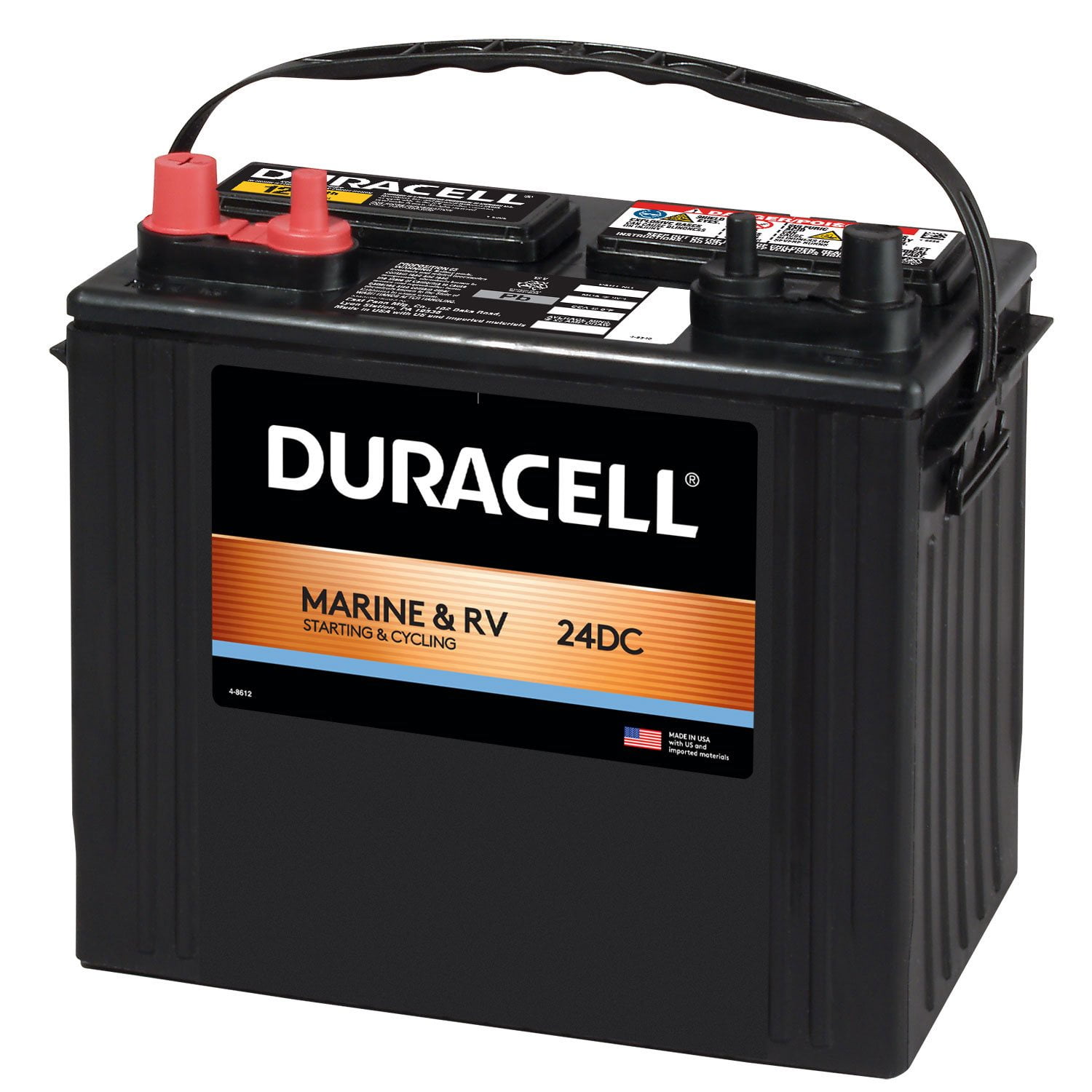

But have y'all heard of batteries marketed as dual purpose before? I hadn't. Any experience with these batteries, link below:

Ayuh,..... Napa has dual purpose marine batteries, that I use,.....
Had good luck with 'em,.....

Dual purpose batteries are very common and have been around for decades. They are quite popular on boats and work fairly well. They won't quite deliver the CCA (or MCA) of a same size starter battery and they aren't quite as heavy duty as a "real" deep cycle. However, as long as they deliver enough CCA they work just fine. That's what I run on my boat. No problems in over 17 years.
