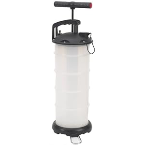

If you're talking about the crankcase oil, use a vacuum type pump like this one:
When I did mine, I just pumped it about 15 times and went about my business. after about 5 min or so it removes the oil....hot or cold!
I use the same pump, no problems. My only wish is that it would hold one additional quart, so I wouldn't have to do two passes to get all the oil from my 5.7L.
Regards,
Rick
I use the Moeller unit that looks just like that. Very happy with that unit, not a better way to change the oil. I always make sure I get 5 quarts out of the engine if it takes 5 quarts. Never had trouble getting the amount out of the engine that it takes by sucking it out of the dipstick. Works great and there is pretty much no mess. Can also suck the old oil right out of the oil filter when you pull it off so you can throw it right away.
