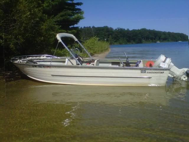

1973 Starcraft 21' Mariner Center Console with a factory original Bimini top in great shape. Trying to find a way to stabilize it so it can be used more. At speeds above 15 turns, wakes, and waves get it rocking side to side quite a bit, 12" or more at the top.
Any ideas are welcome.
Here is the top.
It is attached to a slide for the main attachment, back for storage, forward when deployed.

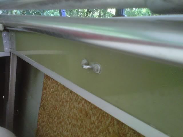

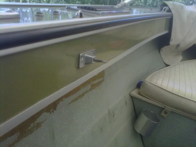

The top tube in the pic above is the front support, it snaps off and mounts to the inner gunwale with a thumb screw fitting.
The back straps attach with clips to these.

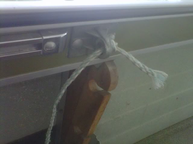

At the front of each slide there is a bracket. I have no idea what this is for but I wonder if these could have been a mount for a sway tube possibly
I use the bracket with the rope shown to hold the bimini slide forward when the top is up but not deployed.

Your 5th pic, of the little bracket in front of the slide, is a mount for a "down east" style rod holder. Don't have any ideas for the top.
Thanks snowman, good info, I had a feeling someone here would know.
