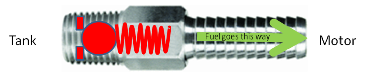

Antisiphon valve
It's the barbed fitting the gas line is attached to

Can this be tested? Or do I just replace it?
Kind of, you should be able to blow thru it with very little pressure from your mouth, don't blow hard. You should not be able to blow thru it with more pressure going back toward the tank
