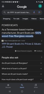

There is no wood on bryant boats .
But I will look for some epoxy to use to fill in the hole , thank you
