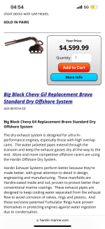

I just recently bought a full system exhaust and thinking about possibly installing my self. Any tips on how to do it or recommend me not trying to do it myself. 454 big block and the exhaust system is a GIL dry system
