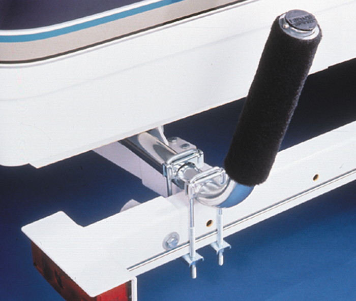

There are a few types of guide-ons. It just depends how much work/money you want to invest.
Here are some photo examples:
Bunkboard type:
Roller type:
Verticle shaft type (although you can make the vertical into rollers with some sealed bearing):
