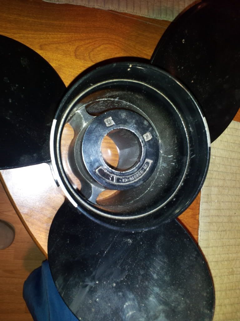

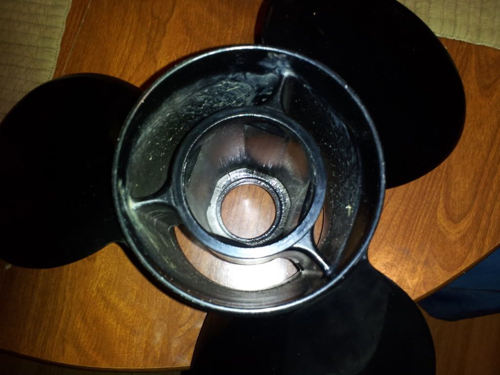

Hi guys,
Just bought a spare prop for my boat. I was able to get a Merc BlackMax 14.5 x 19p prop that was nearly brand new for $75 off of craigslist. It's not ideal, as my boat has a 23P prop that's performing great, but I figured that this would be a great backup prop should something happen on the water.
But looking at it, where the hub would go looks different than what I have on my boat, as IIRC the factory hub has splines that go into notches in the center of the prop, but this one has no such notches for the splines to go.
So I imagine all I'll need is a different hub kit, can anyone help me select the right one?
Thanks!

Ayuh,.... Yer missing the splined insert....

That's a square bore prop. All you need is a hub kit for your Merc outdrive. You can get one here or ay West Marine or most any dealer.

Okay, now I think I understand. When I remove the prop that came with the boat the square insert stays with the prop...I always assumed that it was part of it. Guess not, I'll now be looking for the correct hub kit.
Thanks everyone!

You just need the Flo-Torq kit. Not a big deal- maybe $40 or so.

Also try tapping off the old hub kit on you shaft with a rubber mallet. I'll bet it's siezed on there so spray some WD-40 on it overnight to help loosen it. Normally there'e enough friction that the hub kits stays attached to the prop. I'll bet the PO never greased the shaft.

Yeah...I'm the original owner, the boat is only 5 months old! When I remove the prop the metal insert comes right out, but the rubber part stays with the prop. I think I'm going to buy another hub kit to have on hand but I plan on using the existing one to "test drive" the new one to see how it performs.
Going from a 23 to a 19 pitch prop I expect a bit of increased acceleration but less top speed. If I can hit 45 MPH with the spare I'll be happy!

Tom, the kit you need is merc part number 835257K1 Hub Kits 1 Mercury & Mercruiser Mercury 60-140 HP, V-6,Verado 200-275, Alpha & Bravo under 400 HP $52.50 $49.44
Google the part number for a better price.;):)
