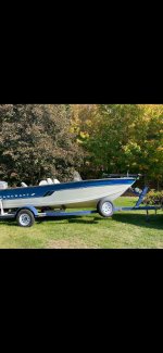

Super fisherman with a 60” shaft. 45lb.
I took it off because it was broken and it is really hard to see over the bow.
The high bow boats aren’t very good for bow mounts. Hard to see over and the high hull catches a lot of wind.
I tried a 30 lb thrust on the stern and that wouldn’t push the boat.
So I bought a 5hp kicker. I’m running it without a bow mount for now.
