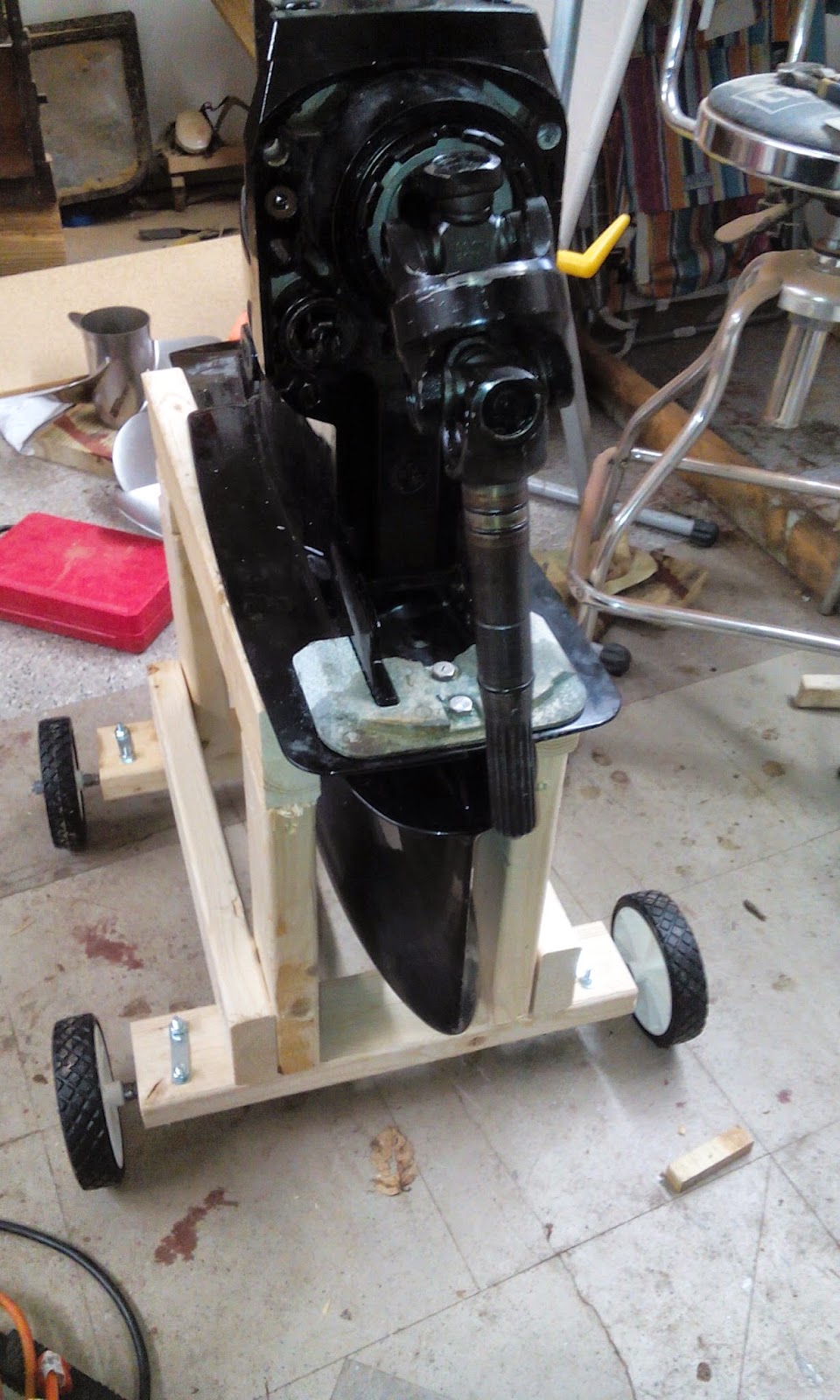

Funny you ask that. i was going to make one tonight out of some 2X4 and some wheels from HF
agallant80
Oct 25, 2010
2,328
Cost me about $50 took me about an hour and a half. Most expensiave part were the wheels at $7 each and the threaded rod at $9 each.
