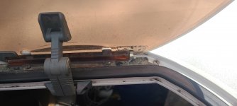

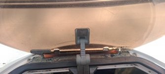

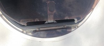

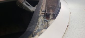

Hey all, Is there a way to repair this Lewmar hinge on my boat? Thanks for any help!20210511_115138.jpg20210511_115143.jpg20210511_115214.jpg20210511_115219.jpg20210511_115344.jpg20210511_115408.jpg
alldodge
Mar 8, 2009
43,204
Doesn't show much material on the lid, but if it can be drilled out straight enough. Then drill the fixed portion and use a stainless or aluminum screw. The fixed portion would be drilled and tapped
