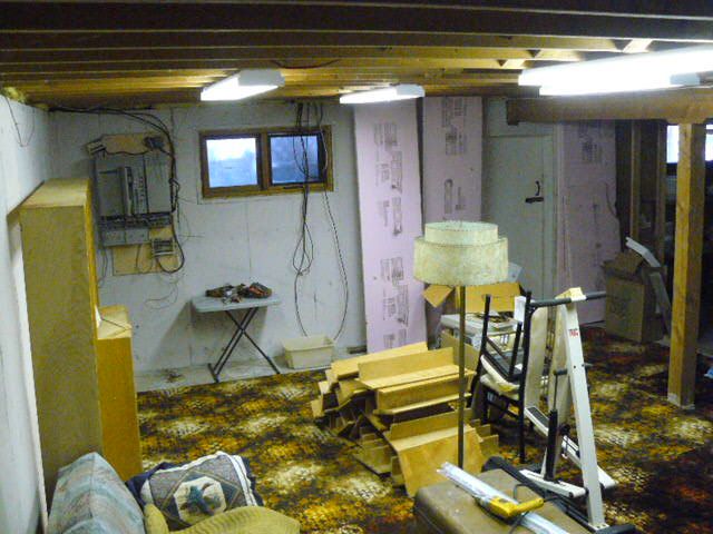

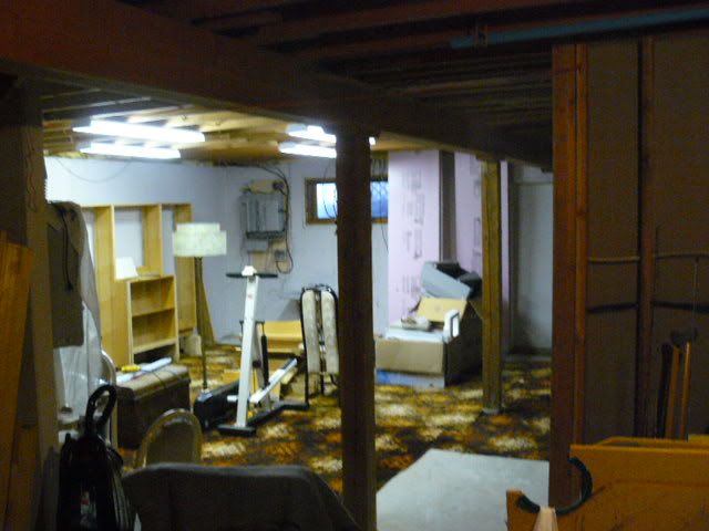

Anyone built a man cave in the basement.
Looking for a little input on everything from building and insulating against the concrete walls, ceiling, wiring AC/ AV stuff, TV and stereo.
Have a small budget, but lots of buckshe materials kicking around to work with.
And for decorating will need neon beer lights, posters etc beer coasters.

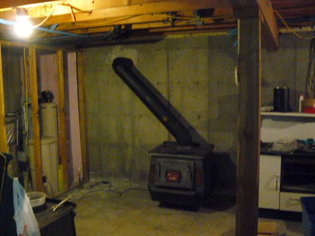

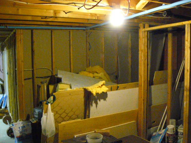

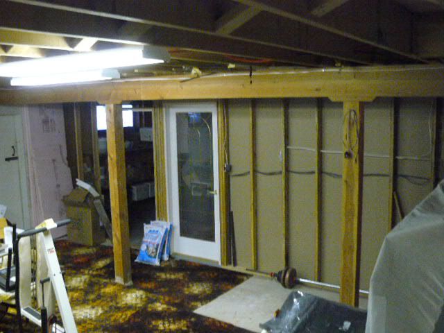

So as can be seen in the pics the heat source is the stove, the studded/drywalled walls that are up will be coming down and moved over to the concrete wall sections and insulated, should I poly between the concrete wall and the wood/insulated sections??
lots of room on the one side for a pool table and can hardley wait to move the walls and open it up down there.
Bye Bye wifes sewing room (to be moved) and the cold room "Hello man cave"

If it is cold in your basement address that for sure. You are not going to want to spend time down there if it is cold. You could put a fridge down there. They put off a lot of heat.

I would say it depends on the climate and how dry the basement is...... concrete floor? If so I would raise the floor at least an inch with foam and make a floor on top of that.
Insulate the walls and stud them. A single ceiling light depending on size....... or are you doing the entire basement?
Neon beer lights ...... find a beverage salesperson and they will have leads to where to get them.

"the studded/drywalled walls that are up will be coming down and moved over to the concrete wall sections and insulated, should I poly between the concrete wall and the wood/insulated sections??"
My basement concrete walls are insulated with that green foam board. It is between the 2x2 studs that the drywall is attached to. After four years so far so good.

Always use a vapor barrier over insulation on exterior walls. Concrete isn't waterproof, even with exterior foundation waterproofing.
