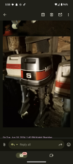

Actually turns out it isn't a blown head gasket. It's a "head plate" gasket or something. So he said it has some broken bolts and a bad gasket on the head. He sent photos and clarified that it's the gasket under the exhaust cover (what he called a head plate", and the broken bolts are the exhaust cover plate bolts. Id have to extract those bolts but if the compression and spark are good I suppose I'll buy it

Welp I bought it. Everything looks to be in working order. The catch is the guy the seller bought it from must have tried to change the thermostat and broke 3 bolts to the exhaust cover in the process. I ordered some extractors to remove the stuck bolts. Any good way to find parts for these? I don't see much when I look up Mariner but I see a lot when I look up Yamaha. Is there an equivalent Yamaha model to these? I believe this is an 82 mariner. I just need a thermostat and the gaskets really. Everything else looked fine.
