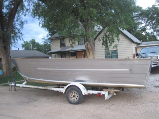

I've been knocking around the idea of either converting my Starchief to an open boat or buying one which I've looked at and doing the same.
I love the idea of the cabin but more often than not it gets in my way being 6'6" tall, and I'd like to lighten up the boat a bit and make full use of the space available.
Has anyone stripped out and re-decked a Starchief as an open boat, either a side or center console? Do I go with the forward or rear deck level? (The deck inside the cabin is about 8" lower than the rest of the boat).
Would you do it to a complete and otherwise ready to run boat? I've got a mint clean 70hp that I'd like to use and I looked at one without it's motor on CL that's been listed for almost a year now with no takers by another member here.
http://jerseyshore.craigslist.org/boa/2472861172.html
I want as bare bones a boat as I can get, just a deck, helm, and motor. I'm hoping I can buy the boat without the trailer for a lot less than the asking price. I looked at the boat some time ago but had to sell another one of my boats before bringing in another project. I have a minty clean running 75hp Johnson that I'd like to use.
Making the boat lighter would also let me tow it with my Ranger, which struggles on the ramp with my Starchief now. I think with a few hundred less pounds or so it may make all the difference.
When I replaced the deck in my original Starchief I realized just how much wood weight is in these. I suppose the cabin and forward seats have to be over 225lbs or so, the rear wall on mine is 3/4" plywood, as is most of the forward seat structure and panels. Not to mention the 400lbs of wet foam I removed from mine. (from the feel of the one on CL I don't think wet foam will be an issue, that boat is super light, I was able to lift the bow and walk the boat around by the tongue, I couldn't do that with mine until I hung my motor. The one on CL is one year older than mine, but looks pretty much the same other than the custom seat boxes. If I hadn't of just redone my deck, I'd probably buy the one on CL and gut mine down as it was in far worse shape when I got it.
One layout that crossed my mind was to put the helm all the way forward at the back of the bow deck, and mounting a glass windshield there. That would leave almost 13 feet of open deck to fish from. No console or anything in the way.
Does a 75hp sound like enough motor for an open 18' boat?

I removed the cap from my Chieftain to make it easier to restore. It lightened it up ALOT. You could fab up new gunwales or use part of the existing ones. There was about 80 rivets I had to drill out to remove it. As for the floor, I would make it all flat. Making it all open would be really nice with lots of deck space to fish from.

We ripped the top off an islander earlier this year and aimed for the exact same result as you have in mind.
Here's the link of the finished product. If you click the picture/video of the holeshot it will take you to the photobucket account that shows the entire project finish to start.
http://forums.iboats.com/showthread.php?t=488772
Good luck with your project!
I'm not sure why I'd have to fab up new gunwales? I had the top off my Starchief and it was only screwed on from the underside of the gunwales, much the same as the windshields are attached. With the rear wall and top off, I was left with two levels of deck, the part inside the cabin is much lower. I was thinking that I could set that as the height of the entire deck?
The hull appears different from the Holiday, the bow deck looks shorter on the Starchief. I've got about 33" from the bow top to what would become the dash board with the top off. The Holiday looks to have a much longer front bow area.
I think I can fit a helm up where the cabin windshield is. if I put a pair of seats there and make the rest of the boat a flat deck, I have all that room to fish off of. The only space wasted then will be the huge splashwell.
I'm not at all concerned about a few screw holes, they can be filled with epoxy. The

My cabin was attatched with solid rivets. The easiest way to seperate it was take the complete cap off. I thought they would be similiar.

Something that I had thought about on those boats is why not leave the cabin but remove the rear cabin wall and level the deck to the cabin floor level? You could drive from inside, still have sun shade and the cabin could be used like a bimini top. You could even use the top of the cabin for storage, things like coolers and extra rods could ride on top.

The hull on those isn't the same as a Holiday, I've looked at and measured both, the fore deck is shorter on the Starchief, meaning that if you put the helm up front, your seating position will be several feet further forward than if it were a Holiday. Myself, I sort of like that idea but if you leave the cabin and move the controls forward, you will have to drive from behind a plexiglass windshield which can't have a wiper installed. The right answer is probably to either change out the windshield someone with glass or to leave the controls outside the cabin.

I thought about leaving the cabin on and doing just that, but at 6' 2" tall the cabin would just get in the way.
I don't think rivets would work on the Starchief, unless they used pop rivets? The bottom edge of the cabin is tubular with no way to back up the rivet. They used self tapping screws up from below into the bottom edge of the cabin rail. If I remove the cabin and the rear railings the gunwales will only show a few dozen holes where they were mounted. The gunwales even already have the rubber inner rub rail as if it could have been built with or without a cabin. The hardest part of removing the cabin is removing the dash and controls. The rest looks like it'll come right off.
I'm really curious as to what the hull looks like under the deck, is the step in the floor done with wood or aluminum? The Holiday looks deeper than the Starchief, I'm guessing that may be because of the difference in rear deck height off the keel?
I seriously also thought about hiding the tanks under the deck if I had to keep it at the rear deck's factory height. Right now that boat has it's tanks in custom boxes under the seats, the seats sit atop of those boxes which also give some storage space beneath the seats. I have a pair of pedestal seats that would work well though but I'd still have to put them high atop a step up in the deck so my feet don't hang from the seat. Right now the seating area floor is raised about 12" off the deck so you can see over the dash and cabin. Stepping down to the left from the drivers position is tough in that if you miss the step you can fall pretty easily in rough water.
On mine now, I simply have a step for the drivers seat but the left seat is at normal height. The passenger in that seat can't see forward.
I sort of like the way this one is set up, I may copy or remake those seat boxes for mine, or just ad some fresh paint and move them to my original boat.
My only concern is weight, being that they're made of 3/4" plywood, I don't suppose their light. Not to mention the two 25+ gallon fuel tanks which they house.
I like the idea of the fuel tanks being midship like that but don't like the idea of not being able to remove them easily for cleaning. I was thinking of making a trap door in the middle which could hold several portable tanks or one big one which could be carried on and off the boat to be filled.
Right now that boat has a VRO motor on it, so the tanks are without oil mixed fuel, I'd most likely run premix, which can be a hassle with an onboard tank if you have to fuel up on the water and guess the amount of oil to add.
