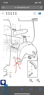

The bushing I need connects the steering fork and helmet together followed by the shoulder bolt that goes through the bushing. I circled where it belongs in the steering fork/helmet. Believe I’m not finding a part number because it’s supposed to come as one whole assembly. That’s my guess, but if that were true I was able to buy the shoulder bolt I needed separate.

Oh gotcha now on the lower side part, with the part numbers given they were showing as where item number 20 is in your diagram.
Being on my phone right now, I can’t really tell but is item number 33 what you’re looking for,

No number 33 would be plastic bushing that goes into the suspension H fork. Followed by a pin that keeps that in place.
