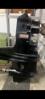

I have a Mercruiser MR-1 drive, serial number 3843732. I’m pretty sure my upper gear case just went. If needed, could I put a newer generation outdrive on it? Say if i found an Alpha 1 that has been rebuilt (as opposed to fixing the old one?) Picture is of my current drive.

SEI will sell you a new outdrive and parts needed to install it as cheaply as you will get. Think you can basically go up to alpha one gen one which is about 1990
Scott06
Apr 20, 2014
6,777
Any mc1, R,MR, or alpha gen one will bolt in and work fine if gear ratio is same

I couldn't find that serial number...what's the engine behind it? Otherwise you can either remove the top cover and count teeth (if there are any left) or count the number of input shaft rotations/prop rotations (again, not with a broken drive)

Here’s a pic of my drive.
