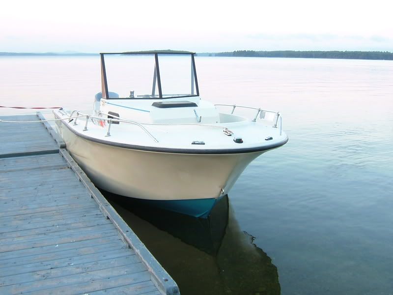

Well a few weeks back now I bought a 1984 21' Proline walk around, after some polishing here she is:
I am really looking forward to the 2007 season!!
So heres a few questions, there are two 1" scuppers in the back, I would like to enlarge these to a 2-3" hole for better draining (saftey) is there any issue in doing this that you guys can see? The new holes will be sealed with epoxy to avoid water into transom.
