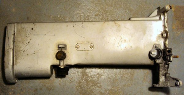

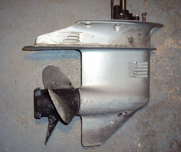

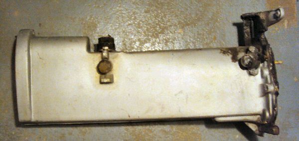

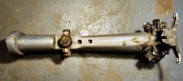

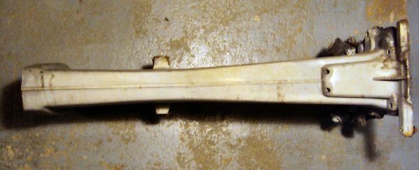

Here's a few pix of the gearcase and the exhaust housing (22 inches long):

Can't tell the actual color by the photos but by the location of the water intake it is a pre 1980 unit. Still haven't been able to reference either of those part numbers.
Most of the changes made in 1980 were due to the cooling system. They moved the water intake and changed the water pump design. When they redesigned the cooling they had to redesign and move the shift linkages. The redesign was due to the water intake becoming easily fouled causing an overheat condition.

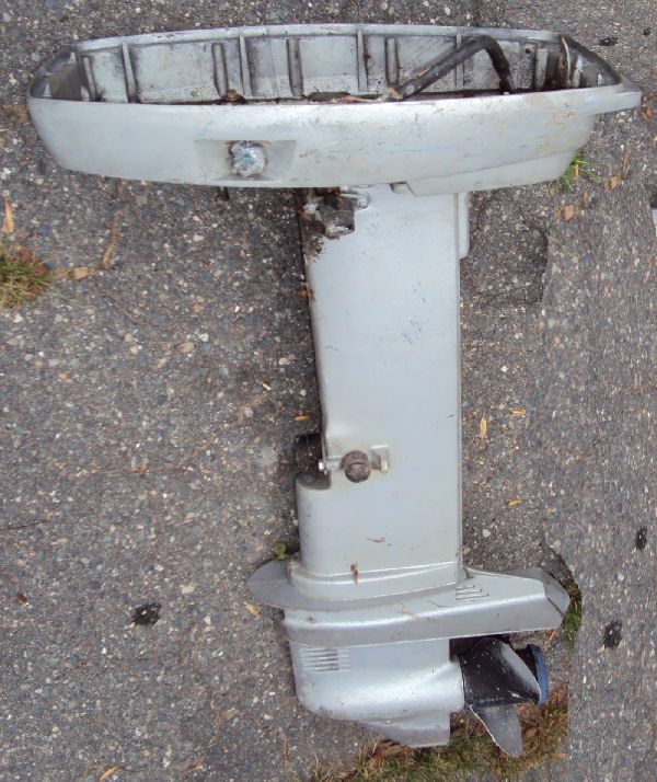

This probably won't help but here it is before breaking it apart.
Also, some of the parts such as the steering bracket (#322884), shallow drive bracket, tie bar, etc., did cross reference to late '70's J/E motors but the Lower Motor Cover/Cowling (#322124) also would NOT show up. Although, there were some crosses to ebay ads which made me wonder what their reference sources were!
