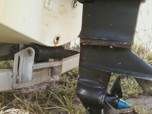

The boat is a 1988 17 foot Cobia center console. Originally it had a 75hp Suzuki, but now it has a 50 hp Force, late 80's era. Obviously a lot less power, and that may be part of the problem. The engine has great compression (135 on each cylinder), and is firing on both plugs. It fires right up and runs smooth at the first bump of the key. (largely due to members of this very forum!
When I drove the boat for the first time on Thursday, it wouldn't plane out, and the boat was moving very slowly at full throttle. It was also making a huge wake for how slow it was going. I don't currently have a tach, but guessing by the sound it didn't sound anywhere near WOT. (I did verify after I shut the engine down that the linkage IS in fact opening the carb butterfly fully). I had myself and one other person in the boat with me; me sitting in the center and him sitting on the seat nearest the bow.
My engine doesn't have a power tilt setup, so I had to go to an island to adjust it since I have to get behind the engine and move a metal rod to a different hole. It was fully trimmed out on my way out - I adjusted it to a center hole, but it made no difference in how the boat drove on the return trip.
Also, my boat burned nearly all of my 6 gallons of gas for what is in reality a short trip - the island and the boat ramp are within sight of each other, albeit they are still a good distance apart.
So, I may have two problems - my prop pitch is 13 1/2 based on the part number. Not sure if this is a good prop for my boat.
The other is that my engine is mounted too low, but I can't set it up any higher without a jack plate. My anti-cavitation plate is 1.5-2" below the lowest point on my transom. See below:
I couldn't get a clear picture of what the symptoms of my engine being mounted too low are, so I don't know what to do first. I did get advice to check and see if I am carrying around a lot of extra water below decks, and I will do that as soon as I figure out how.
Any ideas? I'm still hoping I can use this boat with the current engine for the summer, and until I can afford an engine swap sometime next year most likely. I don't expect it to be a speed demon, but it feels like it really should be faster than it is (naturally, my speedometer on the boat doesn't appear to work....or I was going too slow to register....
