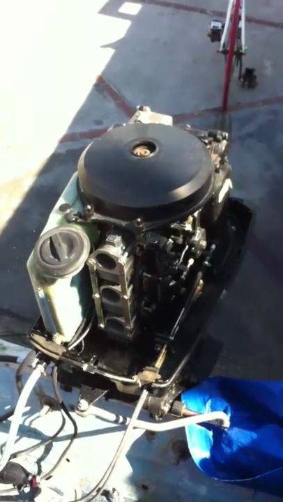

heres a video of me attempting to start it recently. sometimes it would stay on for a bit and sometimes it would just die right after you start it.
at the very end of the boat i tried to give it gas, but as you can see the motor dies when i release the throttle.

It's not running on 3 cyls and if cleaning the carbs fixed it last fall, probably cleaning them again will fix it again.
