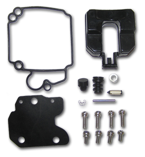

[h=5]CARBURETOR REPAIR KIT: 9.9HP ~ 30HP 4-STROKE[/h]
Carburetor repair kit. Kit includes gaskets, float & needle valve.
Fits:
9.9A & 9.9B 4-stroke
15A & 15B 4-stroke (for 15C 4str., use part # 3BJ871220M)
18A & 18B 4-stroke
25A 4-stroke
30A 4-stroke
Note: Must purchase 3 kits (one for each carb) for the 25/30 4-stroke model
Part #: 3R3871221M
