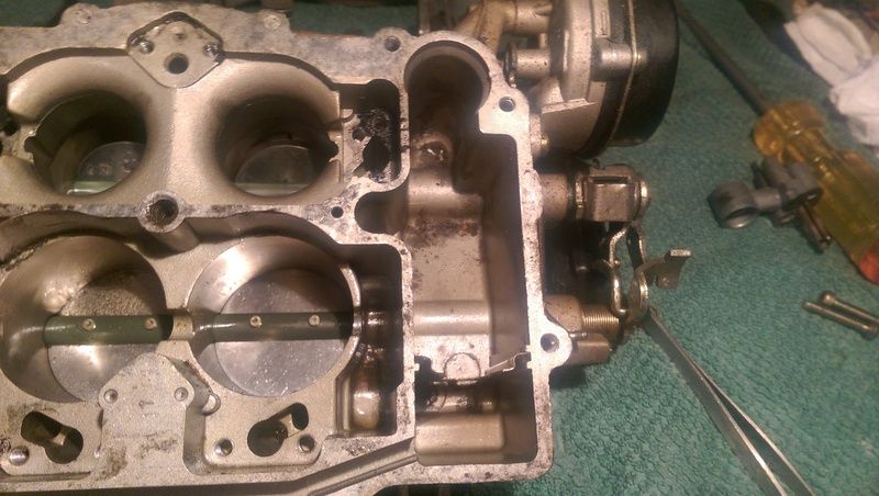

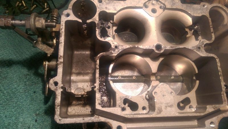

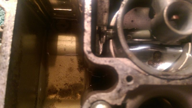

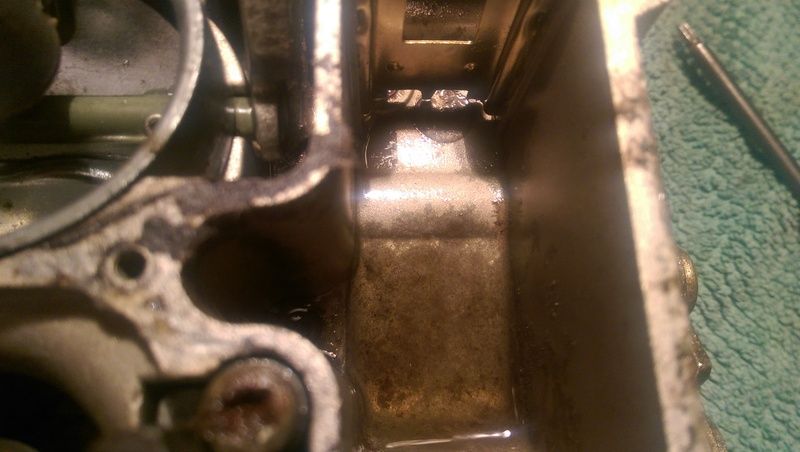

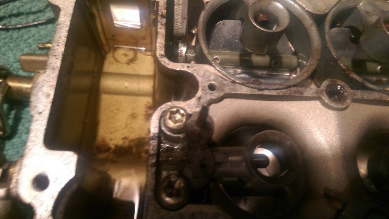

Think I found my RPM surging problem.
Look at these pics of the bowls....
Next step is to clean and re assemble....
gm280
Jun 26, 2011
14,605
Obviously some dirt and junk, but I would clean the entire carb and make certain every passage is clean and open and then install a new carb kit with new gaskets and adjust and use it again... :thumb:

Ayuh,.... Lotsa junk in there,..... Good luck Tony,.....

This doesn't scare me........just don't have the time to finish it right now,
Hopefully this w/e.

Tony if that carb has any little orifices you can send strands of copper wire through to kind of "floss" them out. If any of the holes are really cruddy get a box of tiny drill bits and use the right size to not hog out the holes. They have cheap drill sets at Harbor Freight. But I have not seen any pin vises there which are great to hold the tiny bits.
Ps. I hope you took lots of before pictures, they can be a big help.
