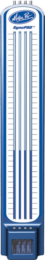

So 1 1/4 turn is the starting point? Also I thought you wanted low rpm at idle so you don't have clunking when shifting into gear,
This is the best way to get it right with this tool?

Hey mate, they don't like you cherry picking someone else's thread. Keep the questions to your thread. No worries.

As for what the Image was, I have no idea, what it was.

I think that tool is a carb synchronizer...probably for motorcycles.
Jan 17, 2019
940
that tool does look like a vacuum synch tool only used on 4 strokes. i have one at the shop for the odd 4 stroke that comes in, but 95% of the time its not needed as the factory sets it and they dont really ever get out of adjustment.
