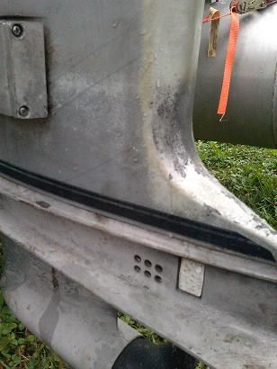

after some reading I think it may be a combination of a bad prop along with the motor height The prop has some nicks and one blade is got a bent spot in it. Im trying to upload pics so You can see.

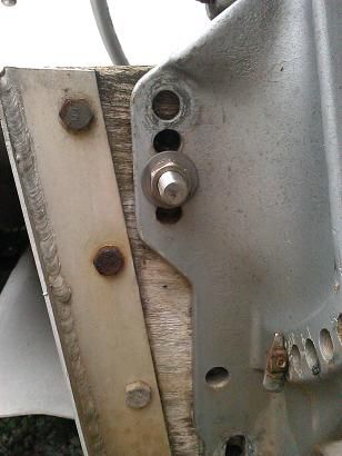

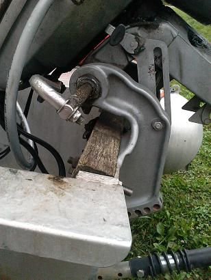

HOPEFULLY HERE ARE SOME PICS. iN THE ONE YOU CAN SEE THE WATER LINE. when running WOT I can see the cav plate.

Can't see the prop. But I will tell you something, That transom wood NEEDS to REPLACED

HarborRat
Jan 3, 2014
51
Rebuild the transom with the same hole locations...but lower the motor. You can see that the motor used to be mounted in the top holes, and can see the marks on the top of the bottom slots where it used to line up. I don't see where anyone drilled new holes, they just raised the motor. Start with the top holes and see how it goes.
