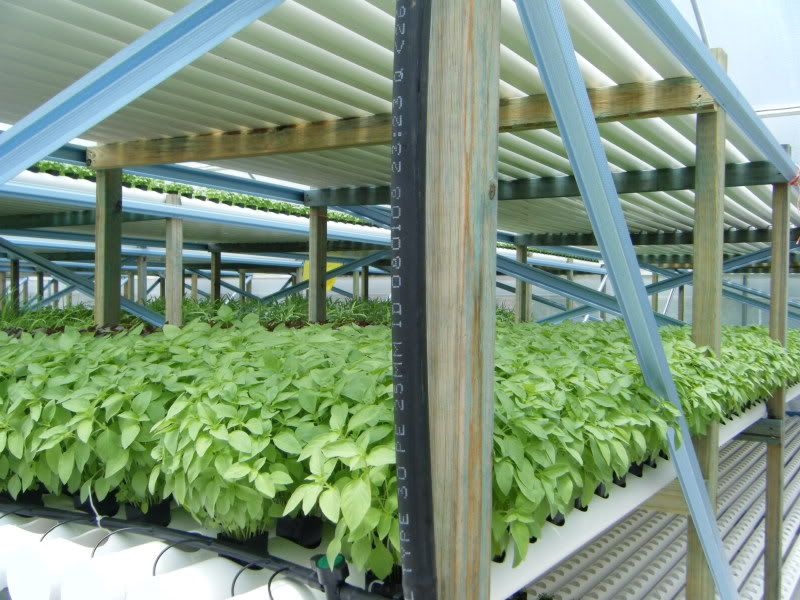

I need an opinion re light to grow plants.

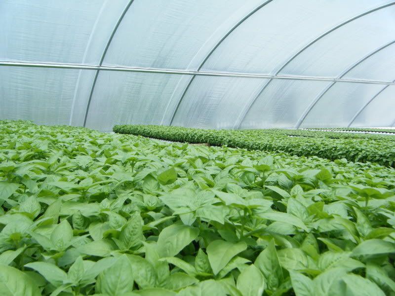

This is what I have - plenty of light from above

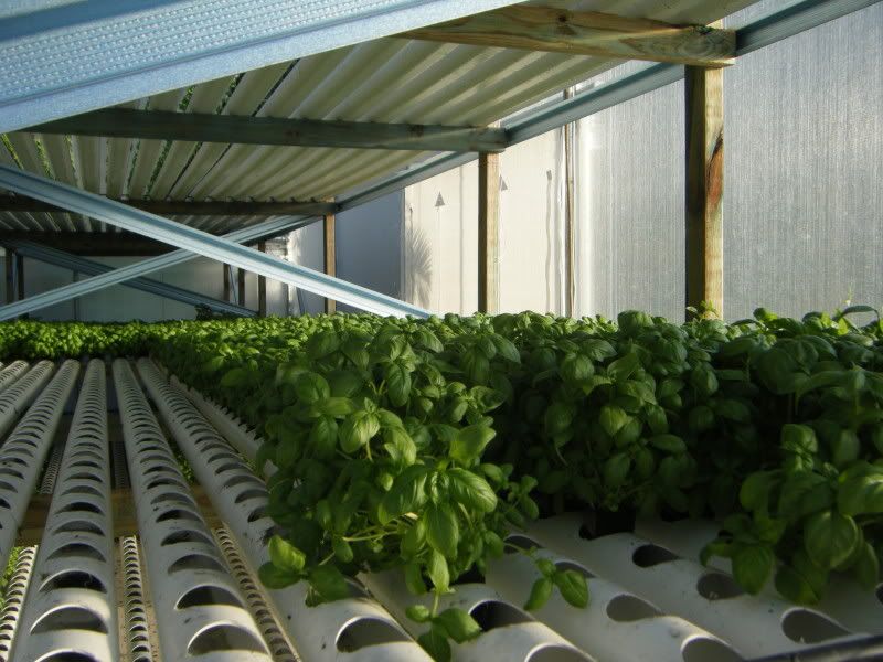

Then the crop on the top grows to this
And the crop underneath gets this much light - although it is saleable, the lack of light slows growth and development and output.

Will the T8s be in a 2 lamp fixture? 4 lamp?
that is a LOT of fixtures, a lot of ballasts..
How do you plan on mounting the tubes?
How many sq feet?
I am leaning towards HID/HPS grow lights on mobile poles, the initial cost per lamp may be a bit more compared to the tubes, but they cover a much larger area..

Re: CheapboatKev - lighting question.
Sorry..
Just took a good look at your set up..:facepalm:
I see the multi level beds you have..
The cheaper T8s..do you know the blue & red output in Nm?

Not sure, but sparkie says he will work out how to raise and lower - but this will be minimal - apparantly best at approx 12" above crop, and fancy basils will grow 12". Lemon balm 8". Cress 6", so not a great deal of movement.
Tables are 1.8m wide and 9m long, BUT outside 25% of tables get enough natural light, the inside (50%) is short. Then comes the big variable, when I remove the crop from above, the light increases massively.
These are the T8's I have been recommended "Osram Daylight tubes, T8, 32W 6500K (full spectrum)".

Sorry, i don't think I answered your question "how many sq feet" correctly, especially if it relates to "HID/HPS grow lights on mobile poles".
The shed is 30m long by 10m wide, and the space between bottom and middle table is 1m, and middle and top table 1m.
Each table is 1.8m wide by 9m long.
Walkways are 1m wide.
