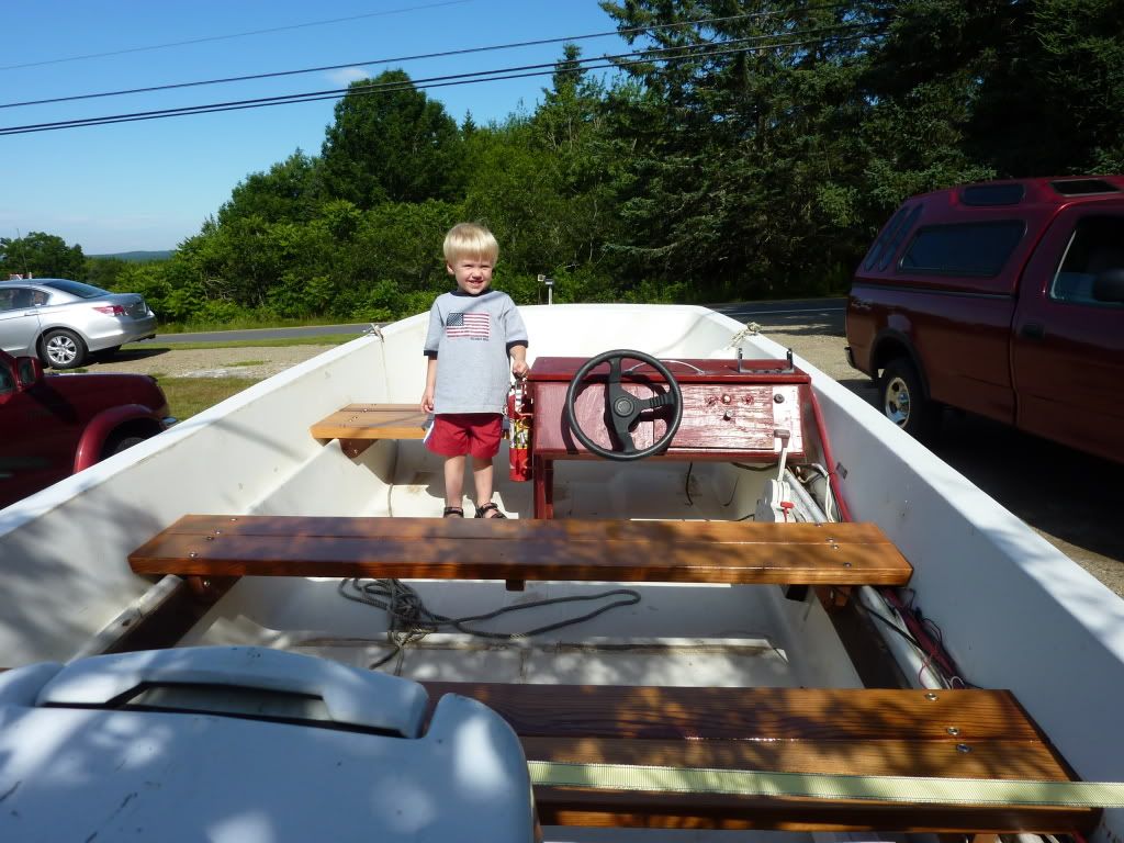

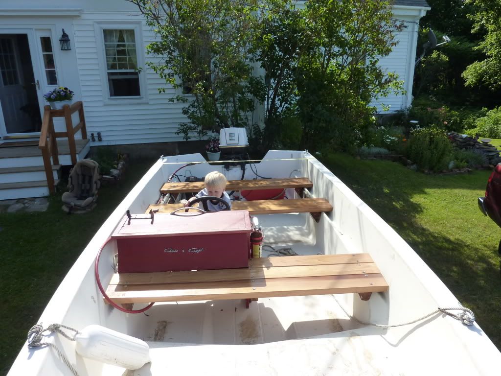

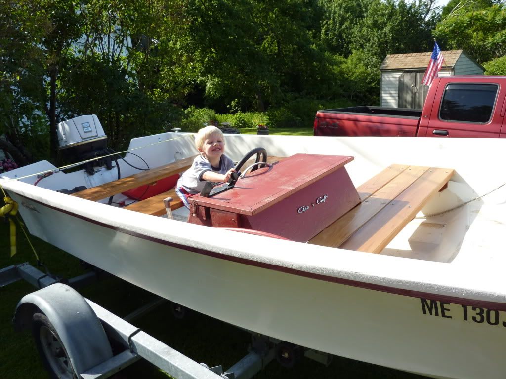

The motor died and so we're working on interior.
Asked the wife, do you want it painted or do you want a used motor. She said she would rather ride in a dirty boat than sit and stare at a clean one.
Now with red cedar seating.
Console rebuild is next.
Bow View:
Stern View:
