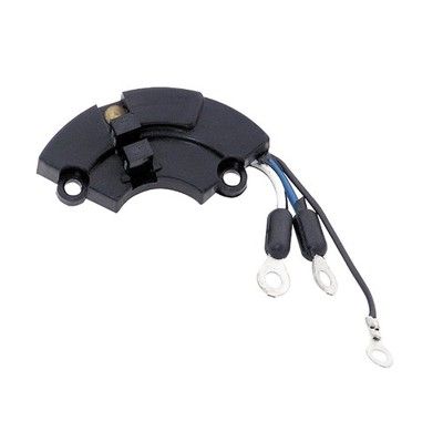

I have 11 amps going into the blue wire on the trigger (drops to 9 when cranking) but only 7 coming out on the white wire
(6 while cranking). Could this be a sign of a bad trigger? it has this style trigger
