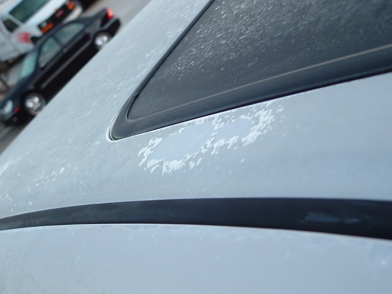

My car is a 97 Honda Accord, silver in color. The clear coat is bubbling off in a few places. I thought I would try some polishing compound but that did nothing. Anything I can do to help this paint look any better?

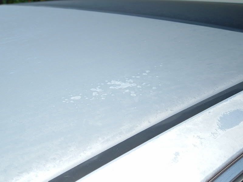

Attached are a couple of pictures. Short of repainting, can I make this better?

Actually, that is a primer issue.
The color coat is supposed to contain a UV protectant. Without it, or not enough, the sun actually goes through the color coat and sunburns the primer. Once that happens, the color and clear coats can no longer adhere.
You'll notice that it is only on the horizontal surfaces.

Nothing you can do but sand it down, use hit it with an epoxy primer, then the sealer/primer, basecoat then clearcoat.
They are kind of fun to do yourself if you have the hankering.
