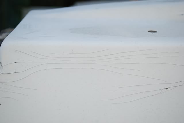

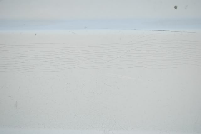

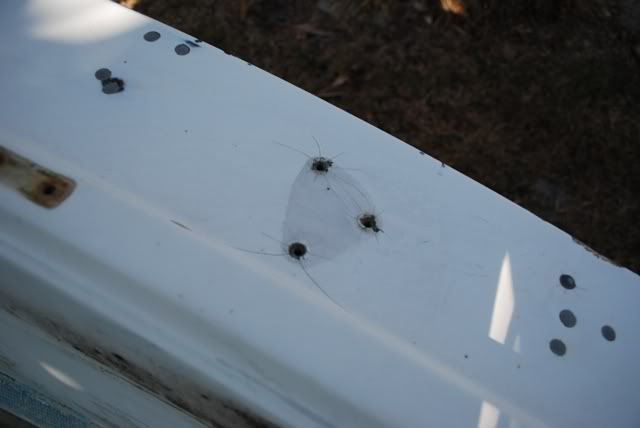

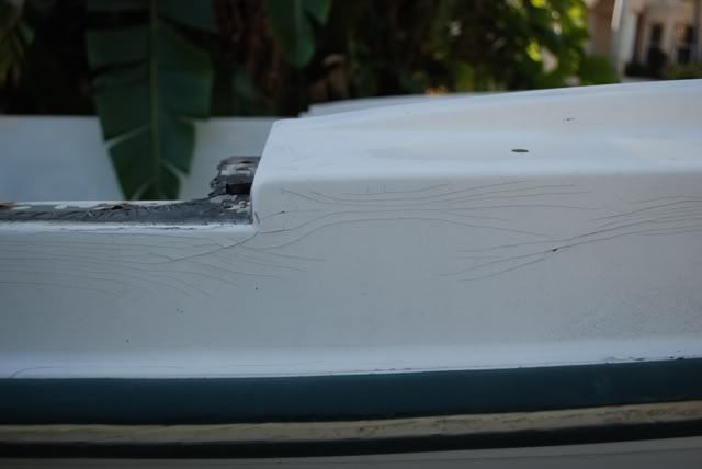

Little info first the boat in question is a 20 foot 1976 Aquasport Center Console Open Fish. The hull is solid and was repainted recently, it looks like semi-gloss wall paint. The deck, also solid as well as the stringers. The transom is like concrete and was obviously redone recently. The motor is a 1985 90 HP Evinrude with VRO, which the previous owner plugged, why I may never know. I have time on my hands to do this right, so I am not trying to take short cuts. There were a multitude of things screwed to the top side of this boat, which I removed, leaving tons of screw holes. This is an older boat, so the gel-coat has taken a beating, has spiderweb cracks all over. Mostly on the sides, where it would rub or bang against a dock as you can see in the pictures. Now here are the questions...
1. I want to fill all the holes and cracks and then gel-goat them when I gel-coat the rest of the boat. What is the best way to fill these holes and cracks?

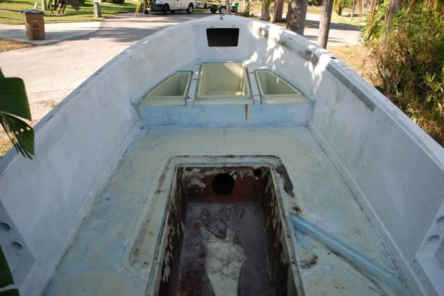

2. The deck is ugly as sin, I had the finish and there is one soft spot, it's a an area of about one square foot. The rest of the deck is rock solid, but it's ugly. I tested the stringers by using techniques I found here, so thanks guys for that. The foam in the stringers is dry as a bone, so I am not messing with them. What I am thinking about doing is epoxying treated plywood and then screwing and gluing it down right over the old deck and then fiberglassing and painting that. Of course I would cut out the crappy area of deck so the rot doesn't continue it's ways. Is this feasible or would it be easier to cut out the soft and patch it in? I also have a big compartment in the floor that I would like to just cover, or perhaps stow the gas tank under deck. The cover for the compartment is large and is very soft and falling apart. If covering the deck is not a bad thing, how would I go about this? If I have the proper fuel tank for under deck, is there any downfall to having the fuel tank down there? I don't plan on keeping the boat forever, so I am assuming the tank would last while I had the boat. Also, there is a chase way for the controls in the floor. If I was to do the plywood over the deck I would be burying the controls, again is there any problem with this, as everything works properly? What kind of paint should be used on a deck? I have little kids, so I don't want them sliding around and getting hurt if the deck gets wet.

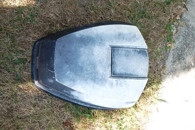

4. I need to repaint the outboard, it looks really bad as you can see from the picture, what is the best way to do this?

The motor can be painted with any marine or automotive paint, pick what you like.
The cracks and fractures are a bugger to fix, they need to be sanded out and repaired, this not only includes the cracked gel coat, but the reason for the cracks needs to addressed. It could be a weak area, rotten stringers, broken supports, impacts, etc, all the this needs to be fixed or the cracks will return quickly.
If it has been painted before and they did a bad job, plus you don't know what they used, means you should remove all of the old stuff before applying more.
A "single" soft spots in the foor normally means there is more rot elsewhere, keep checking.
If you only plan on keeping it a short time you could just lay another sheet of ply down, but it will be much better to do it correctly and replace all of it.

There is no need to hook up the VRO again, and the VRO's from that time aren't the best units on the market, you would need a newer model, this can be pricy. You can put your fuel tank in there if there's room, there are many shapes and sizes to choose, no real down side to it.
