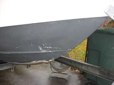

I purchased this 1985 Sea Ox last fall and as you can see from the pictures it needs paint. It has ablative paint below the waterline and has been "polished" down to the bare fiberglass on the front half of the keel from being beached. I believe there is no paint on top of the gelcoat above the waterline.

Your pics did not come through.
I would suggest you stick to hard ablative paint on the bottom. I would have a hard time risking the possibility of using topside paint in salt water. It may be fine, but I would be reluctant even on a trailer boat. Obviously this is just an opinion given I have never tried it.
