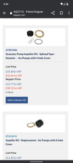

Volvo penta, from the nearest dealer. I'm kind of wondering if this isn't the wrong one. On the other picture from keypart.com, there is one for the 6 hole cover, which is what I have, and the impeller is a touch wider.
It's quite possible. Volvo used/uses many different styles of sea water pumps/impellers. Best bet is to go oem (which you have) but verify by eye the style, number of vanes, hub style, length, etc....
Have no idea the exact p/n for your six bolt/screw cover impeller but can say I've replaced that style very recently, so it is available

I've done some other checking and it does appear the other impeller will work and fit tighter and create more suction. I'm going to try the other impeller and see how that goes...why not at this point? Plus I've always felt that the impeller I got from the dealer was looser and didn't fit as well as other impellers I've used, I just chalked that up to having worked on outboards more. My muffs are the round ones, but they actually seal up pretty well.

Great news... I got the boat out today after installing the new impeller and the boat ran great and didn't get hot even a little! Thanks for all the help, I also fixed a couple things with your advice!
