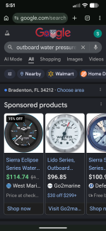

You are supposed to plumb them to the dashboard. I run one on my boat. Plumbed with the same pitot tube line as the speedo
The sierra line is made by VeeThree down here in Florida
