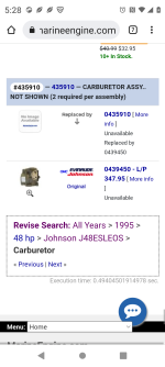

Hello,
I have a 1995 48hp Johnson #J48ESLEOS and the last two times I ordered the 'correct' carb repair kit #396701 including name brand OEM parts, I get a smaller diameter seat that does not fit. I am trying to fix a fuel leak and want the correct, larger diameter seat and matching fuel pin. Does anyone have any experience with this problem? Any insight is appreciated!
Here is two numbers for your carb.....maybe someone put the wrong carb on it.
