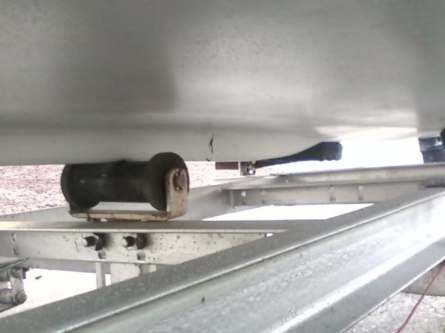

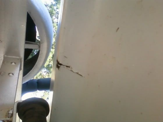

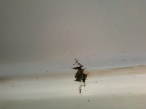

Here is the pictures of the hull. As you can see it is not huge but i need to know what you think caused it and how i should go about fixing it...thanks

That looks like old damage.....did you just purchase the boat? I'm wondering if someone "patched it up" to cover it up. Looks like there is some rot in there. I'm assuming that this is a glass hull?
oops!
Oct 18, 2007
12,932
Re: Crack in hull after first launch
this does not look good zep.
that is the area of the main stringer.....there is no way that crack should have occured in that direction.
i think your stringers are totally rotten.
for a fiberglass boat to crack right thru the glass....well that is just short of catistrophic failure.
the glass can be fixed......but you will need to get inside the hull to do it properly.
im afraid that this is going to be a full gut. and a full blown restoration of stringers....deck....foam ...and most likely the transom.
sorry to give you the news.

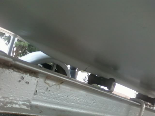

more pics.....i could be wrong......is that on the strake or on the keel ?

I went out there to take the pictures and took a screwdriver out there as well, right in the center of that impact area i could push the screwdriver up only a little bit with minimal force but when i moved it on the outer edges of both towards the bow and stern of that damage i could not for the life of me puncture it with a relatively sharp screwdriver. It seemed to me that that thing either being a "strake" or "keel" is made purely of fiberglass because it did not even feel the small give that you would get it you pushed a screwdriver into brand new wood, it was solid as a rock. That was not there before and i think it is actually some sort of fiberglass or something that looks like wood. I am not sure what the strake or keel are but I do know that this thing runs mainly in the center of the boat probably only 7 feet long where as a stringer would run the full length. It stops short by about three feet of the stern and about two feet of the bow.

the center of the boat......the long line that goes up to the nose....is the keel.......the ones between the keel and side of the boat...are lifting strakes.
i do not know of a manfacturer that put that type of a keel on the hull of a boat....there is either wood in there....or lead.
the dificulty of this repair......is that the glass looks like it is torn.....right thru !....this is a hull rupture. (difficult to tell from the pics....but it looks like it).
if the glass is ripped right thru.....then this is an inside out repair....meaning that the hole must have fiber glass on both sides of the hull.
that means......that you need to pull the deck above the damaged area....and dig till you see the hull and the damage. then grind it till you are at glass.....and then add several layers of fiberglass over top.
then remove the gellcoat from the bottom and fiberglass over that.....then re gell and re surface.
