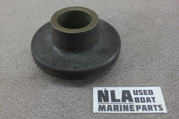

Mercap Thrust hub 45451A1 & Includes washer cupped 12-35965
MerCruiser 45451A1 45451A2 Propeller Early 1965-69 Thrust Washer 120-160hp MC-1....((< plus many other drive models were listed too https://www.mercruiserparts.com/35965-washer ))....This would have been found on some early (1965-1969) MerCruiser Applications
  • EZ Shift IA / IB / IC 1964-1966
  • 120hp / 140hp / 160hp 1967-1969
  • Basically this accommodates the Flat edge on the propeller shafts so this likely needs to still be used with early style MerCruiser Propellers
45451A1 THRUST HUB AND WASHER INCLUDED WITH Gear Case Housing part #, 1623-2511A5, https://www.mercruiserparts.com/45451a1-thrust-hub-assy .... Also sort of seen in the photo below.
