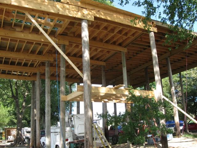

i am thinking i will have two(2) landings one 9 '. From deck floor and one 8' below that with about 5 or 6ft to the ground. So ease of accension is important to me. Not getting any younger:d. Every thing i've read says 33 degrees with 7.25 riser is most comfortable. Will build landings tommorrow and start on steps after that. Never built anything with this many steps before. Thanks for the help.
here is pic from the ground.

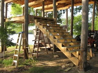

Ok how does this look for a rookie carpenter. had to use 7.25X10 on to make the steps come out right. Tomorrow is the real head banger:D. Going from landing to Deck.
marlboro180
Jun 23, 2009
1,164
Re: Deck floor down
Looking good there!
You may want to make sure you have a good connection where the stringers attach to the deck. I can kinda see the connection you made there, kinda looks like it is just screwed into the side of the joists , which in a long run like that, may not suffice in the long term. A suggestion - If you cannot get any of the simpson hangers in there, you could add a kicker (a couple 2 x 6s) strung between the poles, bearing the stringers on that as well. - Maybe I missed em in the photo though....
When you cut the stringers for the upper set, dont forget to discount the thickness of the tread on the bottom step! :eek::D
You are doing fine- Sure gonna feel different to just walk up to the main floor though ! I know that always feels like a turning point when putting a house together. No more needing the lift and ladders to get up there... sweet!
