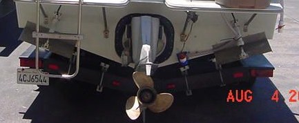

Sorry to disagree with Kelly, but the posted pictures of that boat show that it is NOT a vee-hull. The vee distinction takes place at the stern of the boat, not the bow. The boat in question is a flat bottom boat. I am sure of this because I had one just like it ... a little bigger, however.<br /><br />One thing that you will notice about this style of boat JS is that it will really "slap" the water when you hit a wave while planing. Also, the boat tends to "slide" when making turns because aside from the lower unit of the outboard, there is nothing to cut into the water.<br /><br />Below is an image of a deep-vee hull.<br /><br />
<br /><br />Hope that this helps.

Agreed about the transom distinction. However, in the market place you will still find advertisements, etc., that will call this a V hull. Just to separate themselves from the jon boats and their cousins, the mod Vs.<br /><br />Kelly

Yeah, that small aluminum boat is a semi V. Semi V hull boats start as a V at the bow and transition to minimal deadrise at the transom. True V hulls and especially Deep V hulls have fairly consistant deadrise from stern to bow. Even the V hulled I/O boat pictured above is just a bit shallow in deadrise compared to what is commonly referred to as a deep V hull, but it is close. The boats we consider Deep V hulled boats up here are those big welded aluminum jobs with 20+ degrees of dearise, and they blow through the rough like it isn't there...<br /><br />(Edit- changed Modified V to Semi V, which is the more proper term)
