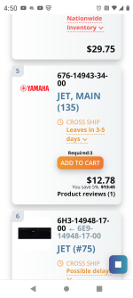

Jets seem attainable but can't you use your old jets or are your carbs missing?

First, thank you for all the info.
The carbs on amazon for the 60 hp are the same including the jet. Strange someone isn’t selling them for 50 hp or maybe there is something I am missing. Only problem to order them is it takes 40 to 60 days to get them.
