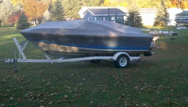

My boat:
1987 Four Winns Horizon 190
150HP BlackMax XR2

Here is a pic of my boat.
