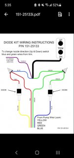

I am trying to install a trim switch for the steering wheel instead of using the two-way toggle switch that came with the trim kit.
There is a diode kit supposedly you can use as below but I feel like a relay would be better solution? The pump is rated for max 20A for 12v circuit.
There is a 4 pin coming from the trim pump that is suppose to be used for control and mounts to a included toggle switch per diagram below. The Trim steering wheel kit is 3 wire only. (up/down/common).

I have no idea how it operates besides the first picture diagram showing the 4 pin wires coming from it. I would assume 2 for Up (red potential)/ 2 for down (green potential). There is a separate 1 wire ground on the pump also.
The diodes appear to keep the purple (potential for trim 3 wire) from backfeeding the pump?

Guessing the pump type is similar to or is a Bennett type pump? e.g., The red and green wires go to the hydraulic valve solenoids on the motor's front and both the blue and yellow wires go to the motor drive windings?
So, yes sure, you can use solenoids and wire it such that your push button switch controls relays which in turn runs the valves and motor......That is if you think the push button switch won't handle the current? That would be my only concern........The pump is rated for "20A max", but does the switch have a current rating stamped on it? The switch should equal to the pump or be greater I reckon........
If you do decide to use relays, you'll have two options,
1) Use two SPDT relays keeping the diodes setup and wire the pump wires to each relays NO contacts.........**Diodes ARE required when each of the two pump wires (red with yellow and green with blue) are connected together.
2) Use two DPDT relays and dump the diodes and wire the pump wires like they do with and as the toggle switch shows.
If you need a sketch of either or both let me know, I can scratch something out, it's not too complicated..

Here is what the pump looks like. 4 wires (2 to solenoids, 2 for switching the solenoids (power), 1 black ground). The lead connects to 4 pin 15ft length wire harness that can run up the dash.
This i the 3 wire control switch.
So my options would be?
1. Two SPDT relays + diodes
2. Two DPDT relays, no diodes.
Seems a lot easier to source marine rated SPDT relays and use diodes also.
This the diode kit:
There is a topic about a banderlog relay kit (mostly plug and play) that got rid of the diodes (I assume some kind of DPDT setup) but that website is gone now.

I watched the video, seems straight forward. I am still confused if I need diodes also with the two relays?
It seems to make the blue input (30 relay connection input) I would need a diode to combine green + blue then connect output wire to the input 30 terminal on the relay. On the second relay, I would do red + yellow then connect output to the input 30 terminal on the other relay?
Any idea what size diode or should I just buy the $30 diode kit?
Also I only assume 20A because that is what the factory fuse kit came with. I don't see any amp ratings on the pump itself, it is a Bennett.
edit: I understand Sam AM I I think now. I do need diodes for SPDT relays or just go DPDT relays. It seems DPDT relays are harder to find though for marine enviroments, diodes increase resistance so not as fast trim movement though.

That trim switch looks to be a lower current type that is basically designed to drive trim relays, don't think I'd drive the pump directly with it.....
So yes, use a relay set up with that type of switch. If it were me, I'd drop using *diodes all together and just use two DPDT's, one (or two) less things to go bad ya know..........
gm280 mentioned above "protection" diodes across the rely coil (not shown), Yes always a good idea, agreed 100%......I don't see them being too critical here in this specific app., HOWEVER some relays manu's offer them built in......GET'UM if you have the option, BUT I wouldn't worry horribly if you do have them.
* These diodes in this config are "current steering".........More on that in a later episode
