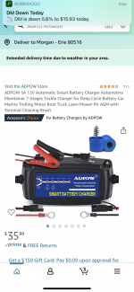

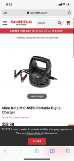

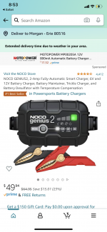

I am using a 40lb thrust minn Kota trolling motor on a 12ft modified V aluminum boat, will any of these actually increase the batteries life a noticeable amount? I am trying to stay away from buying a spare battery to cut down on weight.

These are just small batteries to recharge your main battery.
Yes they are smaller and lighter, but will not provide much power for you.
Possibly a NOCO GB70 would help.
But at $200 is it worth it.
A regular group 24 battery only weighs 40-45 lbs.
Most people can scrap 40# of non essential gear from their boat if weight is truly an issue.
