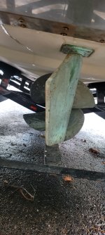

Do you guys think this prop and rudder have been in salt water ? From a moomba 2007 LSV

jimmbo Supreme Mariner Joined May 24, 2004 Messages 14,092 May 16, 2023 #2 I would say no. Some brackish freshwater perhaps, but there isn't any evidence of Salt on other parts of the boat or trailer

beachcraft78 Cadet Joined Jun 22, 2022 Messages 6 May 16, 2023 #3 looks pretty darn good. does it have any pits?
Grub54891 Admiral Joined Jun 17, 2012 Messages 6,393 Jun 7, 2023 #4 Check inside the boat around the engine area, look at wiring connections and thru-hull fittings, look good at them. Any saltwater boats I've seen have green corroded parts inside the boat as well.
