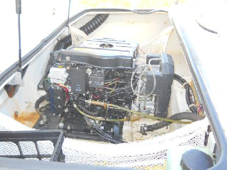

Hello,
I am a newbie here and in boats too
I am from Republic of Moldova and i have an Donzi Medallion 152 with a inbound Mercury SportJet 90, 2 Stroke, 3 Cylinders Engine.
Engine is dead, the crankshaft and cylinders needs to be replaced.
My question is:
Should I buy new engine for this boat or its cheaper to repair it?
If a new one, what are the models that will fit my boat?
Some buying advice?
Thanks a lot!
Boat
http://assets.cougar.nineentertainm...768/assets/momoads/2013/03/07/1/donzi_004.jpg
Engine
http://www.dptsecure.com/images/v2011_large_donzi_(9).jpg
http://media.autobase.co.nz/VehicleImages/Full/1/7/1/1717286_7.jpg

Zemfir: I believe that Mercury sportjets were actually Force engines. They used these engines in many brand jet boats like Mercury, Mariner, sea-ray etc.
In any case, whether or not the engine is Force or Mercury (and in looking at the photos it does appear to be mercury--3 cylinder, 2 carbs) the advice is the same.
NOW: If the crank is damaged as well as the block needing to be over-bored, it is NOT worth rebuilding UNLESS you simply can not find a replacement. A used crank, if you can find one will cost upwards of 100 dollars US and pistons will cost again in the range of 75-125. If the crank is bad, that means that the connecting rods and bearings are damaged too. It is just too many parts to make it worth rebuilding.
You have the option of replacing with a 90 or 125 Force if the engine is indeed a Force block. However, not being familiar with sportjet models, the crankshafts may have different splines than the outboards and you may be stuck looking for a specific jet model engine. If the engine is Mercury, I can not comment since I have no experience with jet models.
