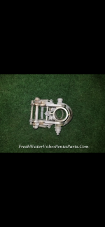

Hi. You definitely do have a reverse locking mechanism. Well known to fail, when they can wear away slightly. See picture. Each side with next to springs there is a catch that engages on the stainless bar

bruceb58
Mar 5, 2006
30,610
He has a DPS-B drive. No idea what part you are showing. Possibly a 270 drive from 40 years earlier.
QBhoy
Mar 10, 2016
8,348
It’s a 290 apologies. Thought he said DPb
