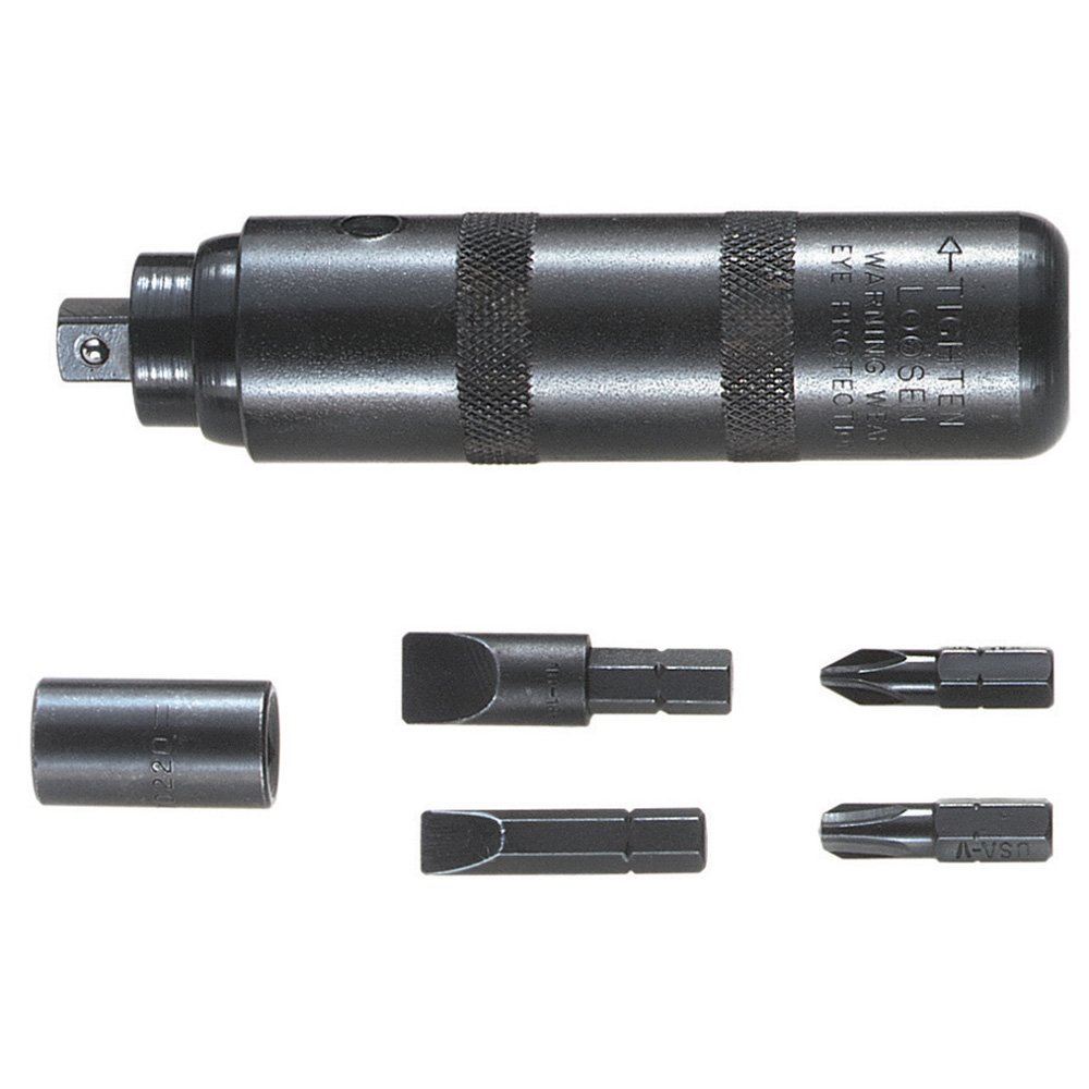

Having difiiculty loosening the drain plug screws on a 1986 Chrysler Force 15 outboard. Any suggested techniques. Also, does anyone know if i can get replacement screw/washers for them? Unable to find any parts online.

I ground one out of an old extension and put on my "manual" impact driver, be careful not to hit it too hard, There is a lot of the same question on this forum with some good how too's, do a search on "how to remove stuck drain screw". good luck :)

impact driver
