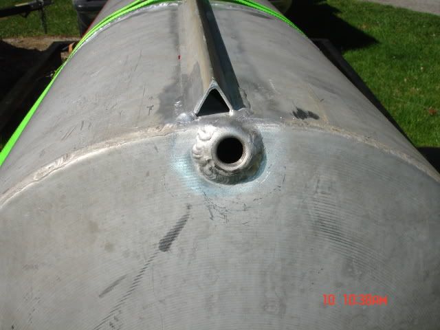

I had them put in mine too, only problem is you don't know a competent welder. Look around and see if there is a truck body place around, they are good at building fuel tanks which are just smaller pontoons.
For a while I ran around with holes drilled in the back of the tubes, the .080 tube wall threaded (for what is was worth) with a 1/4 NPT tap and brass pipe plugs rtv'ed in. Might not have been kosher but it worked.
Here's a pontoon I had built for a project boat. This guy is a trucker who used to build tank cars. Welds for $20/hr cash. GREAT guy to know.
