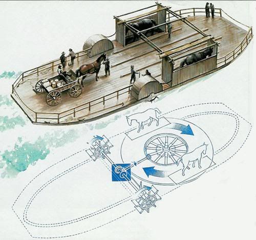

Why go four stroke when you can go with original horse power? Here is the plan........

Re: Dumb question (OK be nice, it's just a thought)
hells yeah!! and you can keep a spare pony on the back if one of them breaks down or you need a little extra oomph
Probably a lot of torque in that 2hp boat but would be a tight fit in my 12 footer. For now i will wait and see how long this old motor holds up. Was just wonderin if anyone else had a crazy idea like that. Looks like B&S did already. Its a bit updated over the std motor but whatever it takes.
