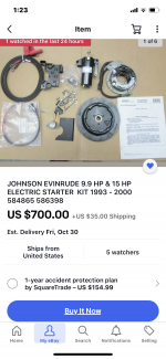

Hello, 93 Evinrude 15hp. Just got electric start kit in today with push button start. Paperwork shows to install everything to starter and rectifier. I guess I don’t need a solenoid?

the selenoid is for the transfer of high amperage load to the starter with the shortest route possible
key contacts will burn up otherwise.
38,592
The push button switch at the motor is ROBUST and no solenoid needed !

The kit shown in the picture has the battery charging coil and the rectifier too !!
Yes, it does so I will use those. The instructions call for me to use an OMC moly lube on the crankcase boss? What else can I use in place of that? Some marine grease?
